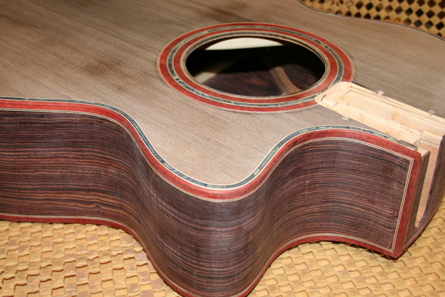

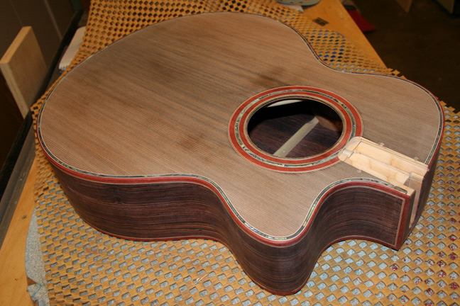

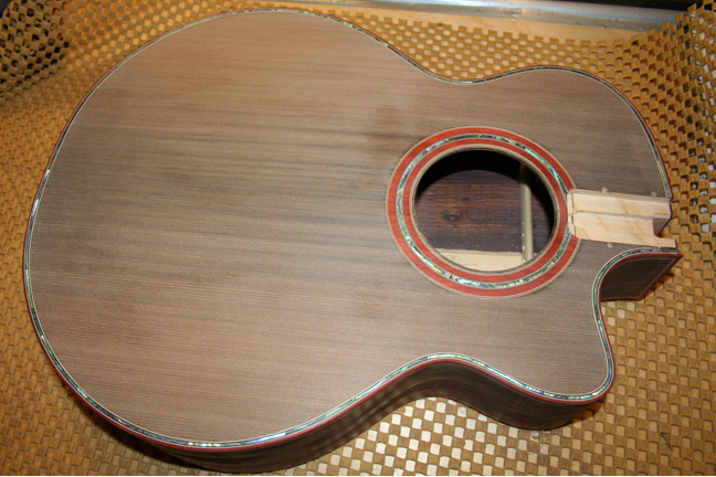

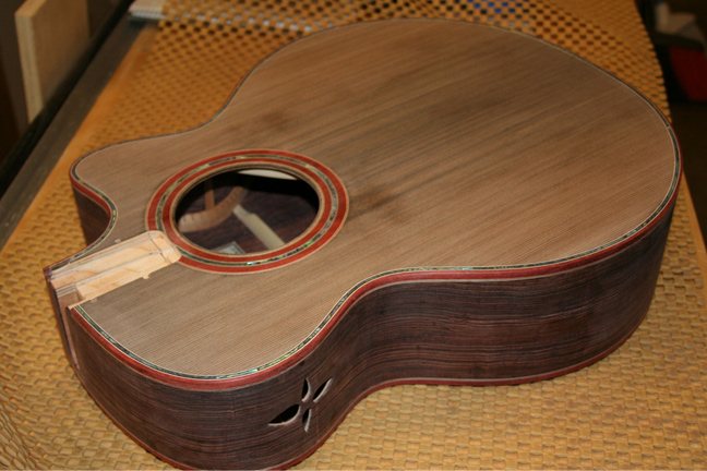

Well, this guitar took me longer to finish than I expected. The double top was a curve ball, the initial top got stepped on by accident and the pearl took way too long to arrive! Besides that eveything else went according to plan.
Now the box is ready for finishing and turned out pretty nice. (I'll finish the nech with gunstock finish later!)

Love that sinker redwood!!!!!
PostPosted: Mon Nov 06, 2006 5:28 am
That is going to look STELLAR under finish!!!
Fantastic job Peter! I really like the soundport and the bindings complement the dark woods perfectly...
How do you plan on finishing it?
I'm really anxious to hear your impressions on the double top (tone wise)... Very interesting concept.

Thanks guys!
I'm thinking catalized urethane.... nice and glossy!

Wow, Peter, that is a real beauty!!! I love that binding with that wood. Is it bloodwood?

Double top Sinker Redwood and Engleman Spruce.
Allied sells the sinker wood at times.
Ron, you are right.... bloodwood it is!
